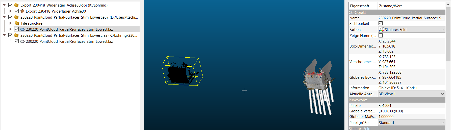

First Case:
Point Cloud "Global Shift/Scale" while importing with "Point in original coordinate system (on disk) x=-11.015, y=12.208, z=12.628 which suggests a transformation of 100 in the x-direction will result in "Point in local coordinate system" x=88.9858, y=12.208, z=12.628. I do then apply Aligh Tools while picking three points on a mesh. This leads to a transformation matrix of
0.921720 0.022978 -0.040241 791.170349
-0.023561 0.922493 -0.012919 983.736084
0.039903 0.013930 0.921916 83.210899
0.000000 0.000000 0.000000 1.000000
See the first Screenshot for the result of reimport into Cloud Compare.
Second Case:
Point Cloud "Global Shift/Scale" while importing with "Point in original coordinate system (on disk) x=2585844.635, y=5705976.530, z=92.5820 which suggests a transformation of -2585800.00 in the x-direction and -5705900.00 in the y-direction will result in "Point in local coordinate system" x=44.635, y=76.53, x=92.582. I do then apply Aligh Tools while picking three points on a mesh. This leads to a transformation matrix of
3.657363 1.644496 -0.182341 463.963867
0.725578 -1.991666 -3.408918 1481.146362
-1.486994 3.072917 -2.111859 150.970352
Same problem while reimporting.
If you want, I can share the to be transformed point cloud with you and my CloudCompare project. I think the problem is my skills and not the software, but I do not find my mistake.

First Case:
Second Case:
- Sc1.png (94.37 KiB) Viewed 15506 times

So I finally had the time to look at this.
Only the coordinates/values of the 'Global box center' should matter. These are the values that will be exported. Most of the file formats support large coordinates (apart from STL files I believe). For the other, we always export 'Global coordinates'. The local coordinate system is only temporary and within CloudCompare.
If you export to LAS files, you can set the 'LAS shift', which is similar to CC's Global Shift in its principle. But whatever values you choose, the exported coordinates will be the same. However, when you re-import the cloud, you are not forced to use the suggested shift. You have to set the shift carefully when using different clouds so that the local coordinate system is the same for all clouds.

Re: export of aligned point cloud to mesh with geo coordinates
Hello Daniel,
okay, I am a step further!
To my process: I have exported 5 different qualities (Lowest, Low, Medium, High and UltraHigh) of this point cloud from Metashape. The first point cloud (high quality), with which I performed the registration, is showing the correct coordinates under "Global box center". The remaining four point clouds, to which I then applied only the transformation matrix, have only those of the matrix under "Global box center". I think this is where my problem lies.
