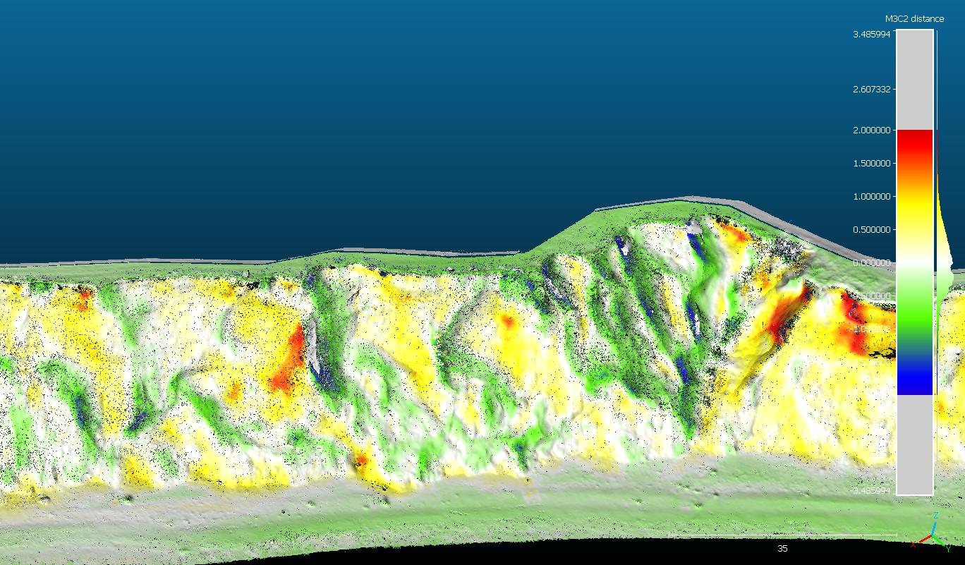

m3c2 results with d = 0.5 and max depth = 10

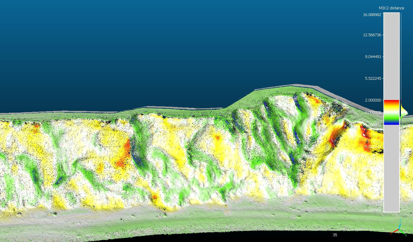

m3c2 results with d = 0.5 and max depth = 2
