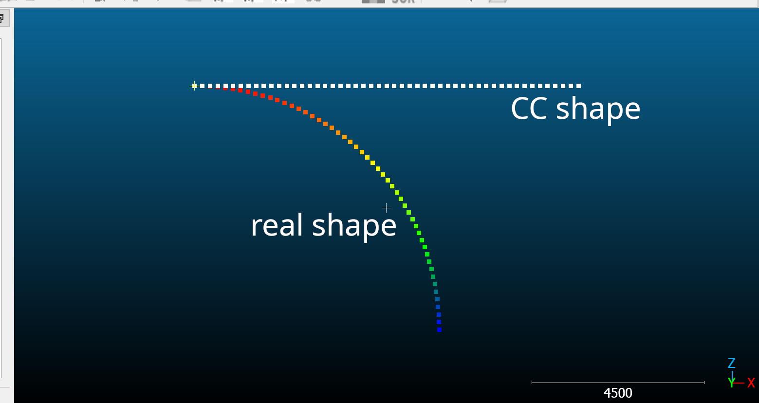

If we open UTM xyz , CC uses cartesian coordinates while UTM has curved Z reference axis (sea level) (earth curvature)
I sent you an email containing python code to prepare UTM coordinates to CC and reflect real shape
I hope you can check it
DA523
Posts: 186
Re: Convert vertical datum in CC
Post by DA523 »
What do you mean?
Suppose a ship travels inline with equator for a distance of 10000 km (earth circumference/4).
If z=0 y=0 and x from 0 to 10000 km
GPS coordinates are xyz in meters( UTM) and z is referenced to sea level which the same of earth curvature
CC represents track in straight line not curve
Can GDAL or other software prepare UTM to be represented in CC in real shape ?
utm to curve.png (34.27 KiB) Viewed 17365 times

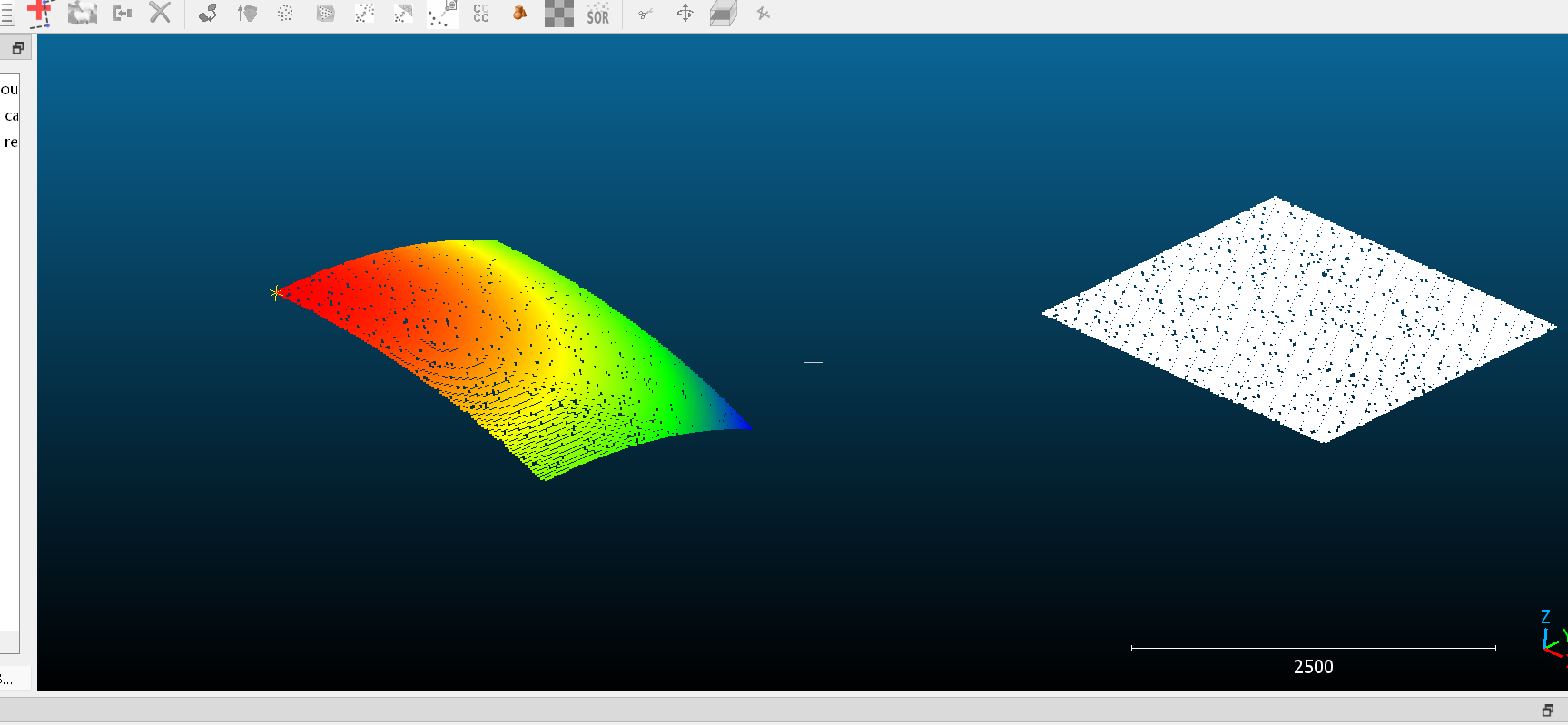

attached 3D pointscloud example
Screenshot (146).png (79.51 KiB) Viewed 17363 times
check CC file below

The real shape of ship track is ARC not straight line because earth curvature
GPS use z referenced to sea level (curved )
Because CC uses Cartesian coordinates ,it shows as straight line not curve line
Is there any existing software,lib which prepares utm to Cartesian so CC can show real curved line ? GDAL ?
