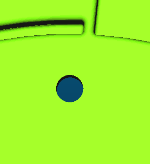

When comparing two aligned .STL files (made from solid bodies in SolidWorks), a 2mm thru hole I added in one part does not show up as a difference after using the "Compute cloud/mesh distance" command. Is there another way to highlight these areas where material is completely removed? I have tried swapping the reference and compared but this does not work either.

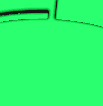

Original mesh, same location as other image but showing that no hole visible.
No Hole.PNG (4.78 KiB) Viewed 8251 times
This is after the mesh comparison is run and the original mesh is hidden.  Difference at this area is considered 0 even though there is a complete removal of material.
2mmHole Compute Mesh Distance.PNG (5.12 KiB) Viewed 8251 times

Are you maybe using the 2 STL files directly with the C2M (Cloud-to-Mesh) distances computation tool? In this case, as the compared mesh is replaced by its vertices, if they are too sparse, then you might miss the hole as no vertex is present in this area.
One solution would be to sample a lot of points on the compared mesh (Edit > Mesh > Sample points') and then use the resulting cloud with the C2M tool.

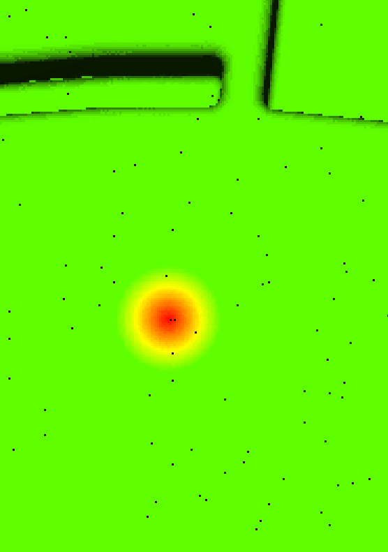

Thank you Daniel! This does show the hole now at the cost of making the mesh a little slower to manipulate (I had to go up to 10,000,000 points to get a good resolution). I think I will update my procedure to use both methods of 1) comparing the two aligned .STLs and 2) converting sample A (base CAD) to a point mesh and comparing with the sample B (CT Scan .STL).
