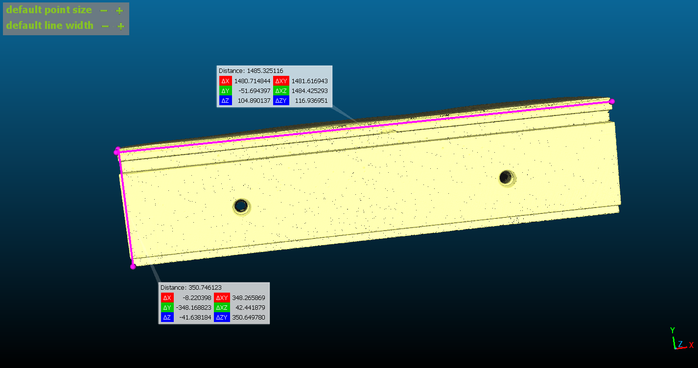

Hello everyone! I am very new to CloudCompare and point cloud models in general. I have been using CC for a few weeks and it has been really great!
I have a 3D point cloud model and mesh of a structural tunnel component. I would like to measure the length and width of it.
For now, I only know how to calculate these lengths using the "Point picking" function. However, this function is manual and is subject to the user's point-clicking accuracy.
Is there an automated way that could measure the lengths and widths automatically and more accurately? Maybe with some kind of Plug-ins? Thank you.

Not that I am aware of...

daniel wrote: Thu Apr 18, 2024 1:50 pm Not that I am aware of...
Ah it's alright, thank you nevertheless !

If it is aligned to the bounding box, you can maybe use that.
