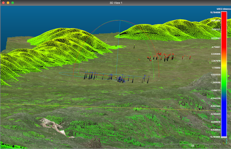

I am subtracting two point clouds and am finding some extreme errors in my M3C2 subtraction where there are no points located in the original point clouds.
Here is the M3C2 difference between the two clouds. This projection is using the mesh 2.5D best fit with 1m max edge length to visualize the error.
As you can see there are the pinnacles of red and blue which are a difference of more than 5m (impossible at that spot).

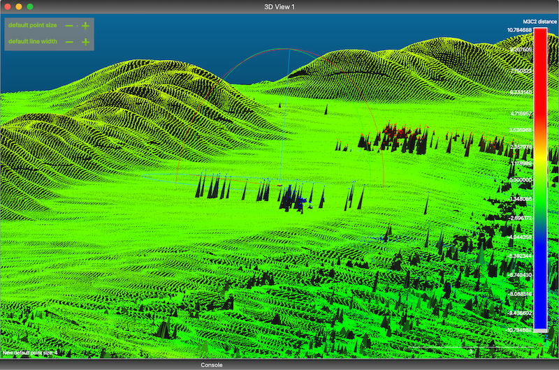

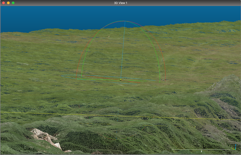

As you can see from the point cloud, that there are no points in those areas to create that pinnacle. First is the baseline, the next is baseline overlaid with M3C2

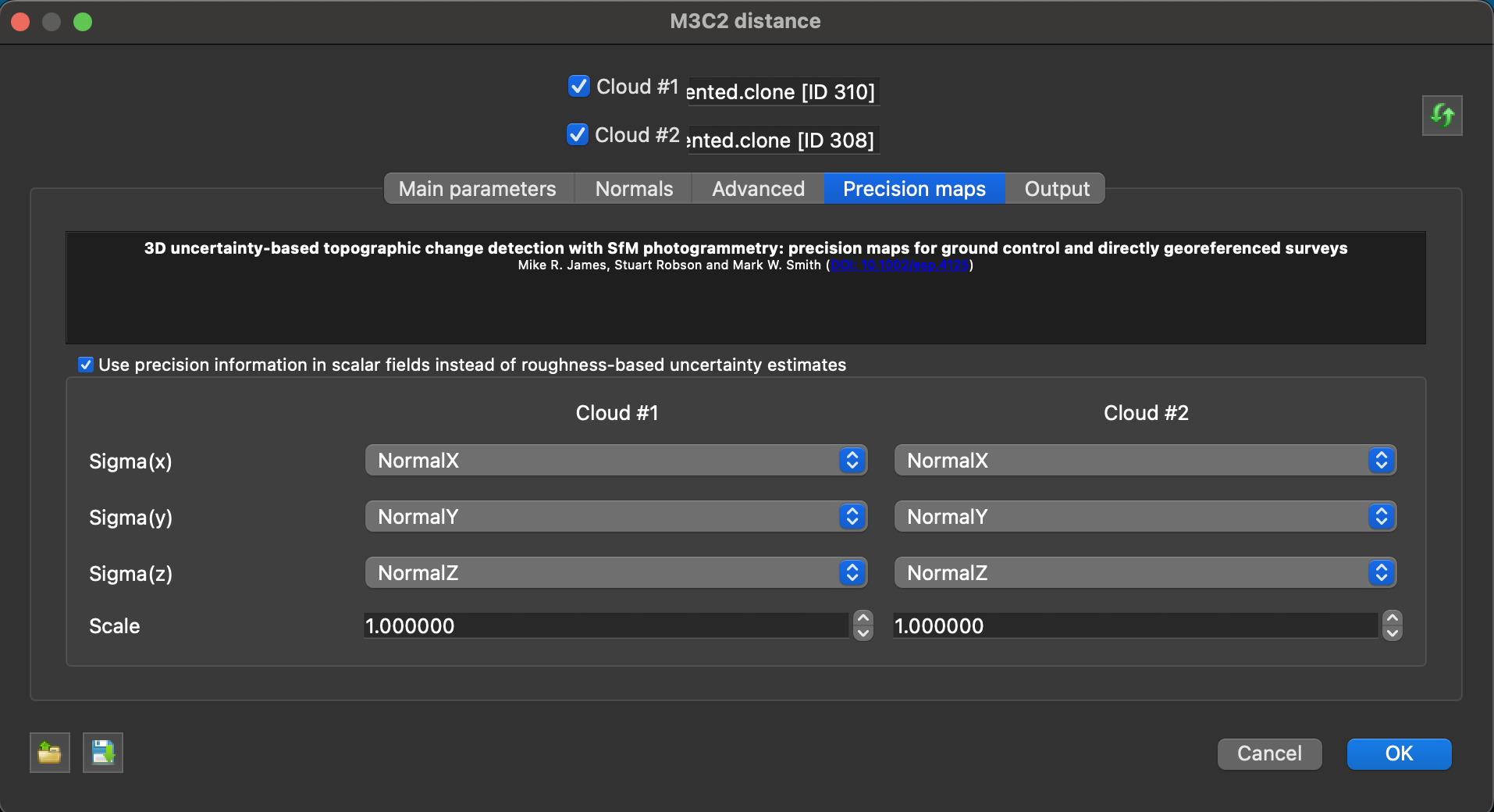

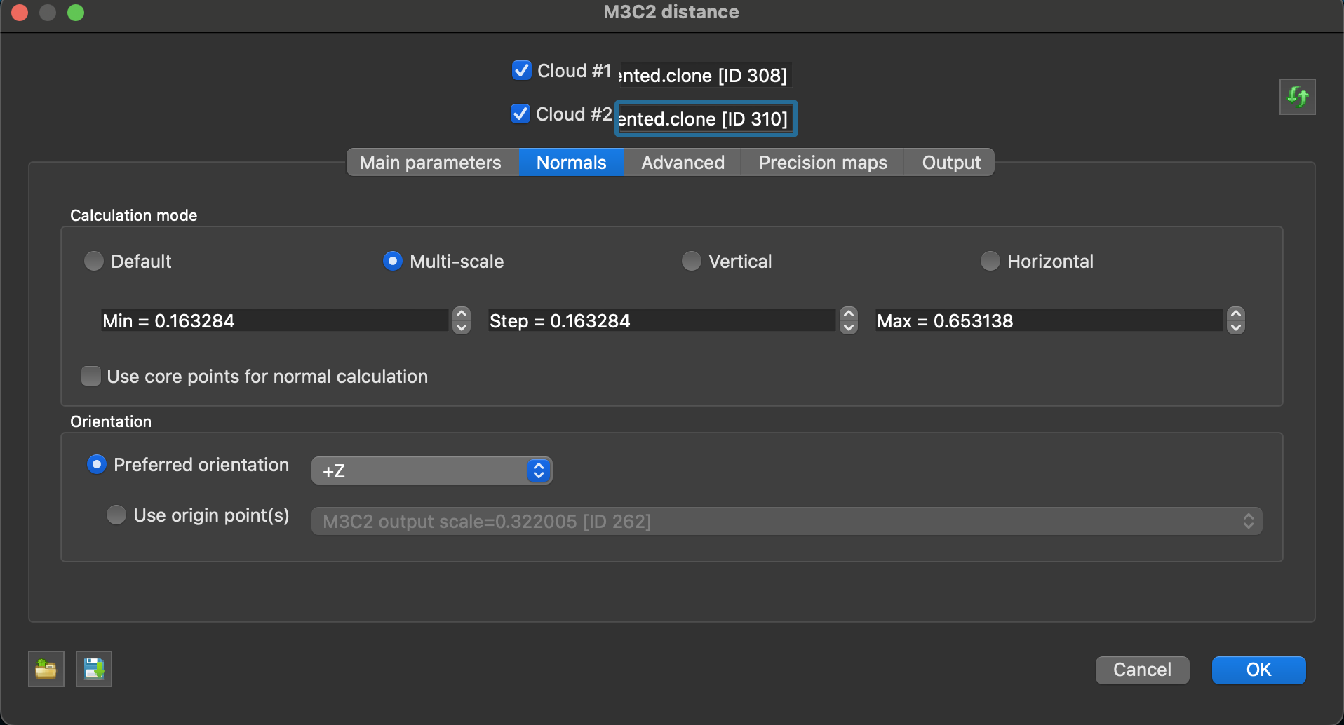

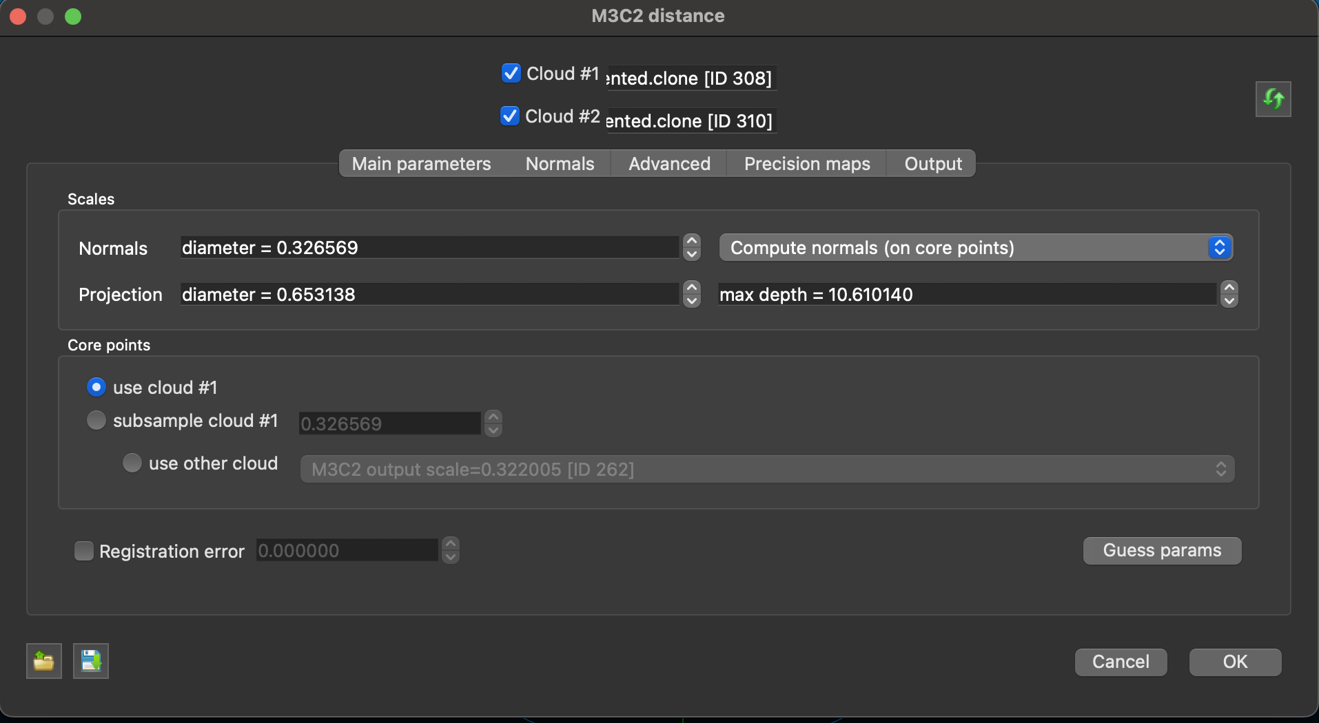

My parameters for the M3C32 is as follows: I used the "guess parameters" feature and it provides a value double my point cloud density distance.
Screenshot 2024-06-11 at 12.06.42 PM.png (168.59 KiB) Viewed 4164 times
Screenshot 2024-06-11 at 12.07.07 PM.png (157.95 KiB) Viewed 4164 times
Screenshot 2024-06-11 at 12.11.18 PM.png (172.68 KiB) Viewed 4164 times
These are SfM point clouds and thus using the PM. I selected yes to use the precision maps.

Sorry, I'm confused: what do you mean by subtracting? Due to how M3C2 works, the 'pinnacle' points are necessarily coming from the original cloud (and from the same cloud as the other points). Isn't it simply noise?

Sorry, subtracting is the wrong term with M3C2, but calculating the difference between two clouds. How do you limit the noise? Is there a step in running M3C2 that I can take? I have tried increasing the diameter of the normals and projection but I get the same thing.
