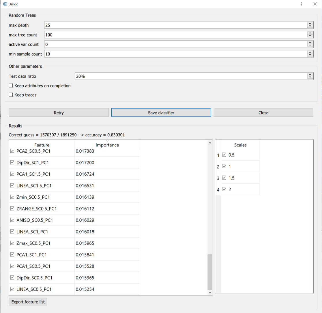

I used the following settings,
Max depth: 25
Max tree count: 100
Active var count: 0
Min sample count: 10
Scales: 0.5:0.5:2
Max depth: 25
Max tree count: 100
Active var count: 0
Scales: 0.5:0.5:2

Please provide the initial parameter file.
Did you launch the training on the overall dataset at once?
Re: Error when loading classifier
I launched the training on the railway_000033.laz file at once, without using a subset as core_points.

I launched a training with the same parameter file and the same Random Trees dialog parameters. The classifier is quite large, about 700Mo, but not as much as yours. I can load it after to classify other points. Are you sure about your configuration?
Ok, thank you very much. I really appreciate your help!
Regarding this,
Could you clarify? Do you mean if I installed CC and its dependencies correctly, or do you mean the 3DMASC settings/configuration?
Anyway, I will give it another try. Sounds like it would be useful to know if I can reproduce my issue.
Regarding this,
paul.leroy
- Posts: 52
- Joined: Tue Dec 01, 2020 1:21 pm
By configuration I meant 3DMASC settings. Yes, being able to reproduce the issue is mandatory.
