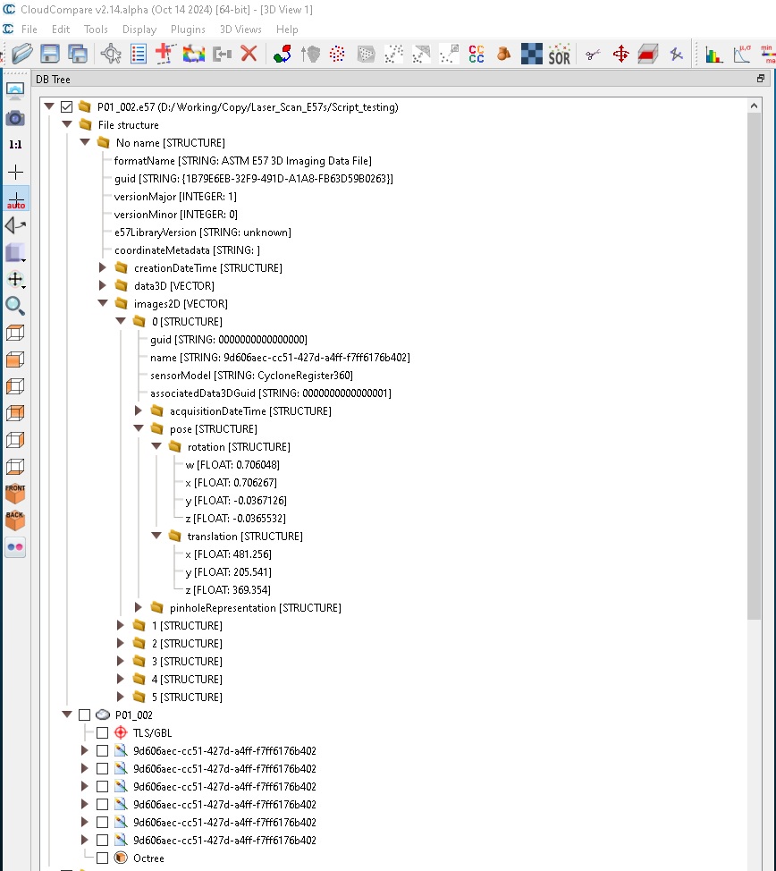

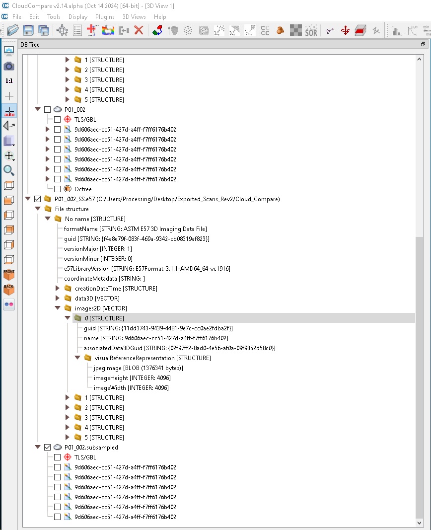

When comparing the two scans folder structure, there is no pose information copied for each of the cube face image. When then importing the output into the cyclone register, faro scene, e57 inspector or any engineering package i have tried so far, the E57 no longer imports with images in the right location with the scan.
The two attached images show the original scan folder structure with image pose information (Top) and the new folder structure of a scan, which was exported as e57 and then reimported into cloud compare (bottom).

Can you test the latest 2.14.alpha version?
I've updated it so that the image camera and pose information are always stored and transmitted to the subsets of points created during subsampling for instance.
Can you confirm that it works with other applications?

Good Morning Daniel,
Great work it looks like you have fixed it. I have run a group of scans through the latest Alpha 2.14 and they have worked in a number of software packages perfectly.
I have a larger test running with a script overnight and will test a few more engineering packages tomorrow but things are looking great so far.
I appreciate the fast response, if i find anything else of note i will write back here.
