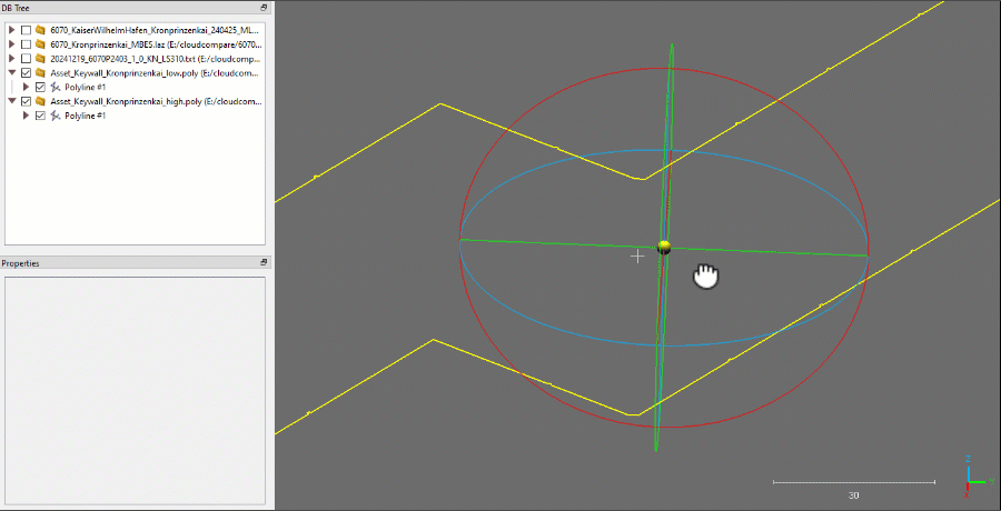

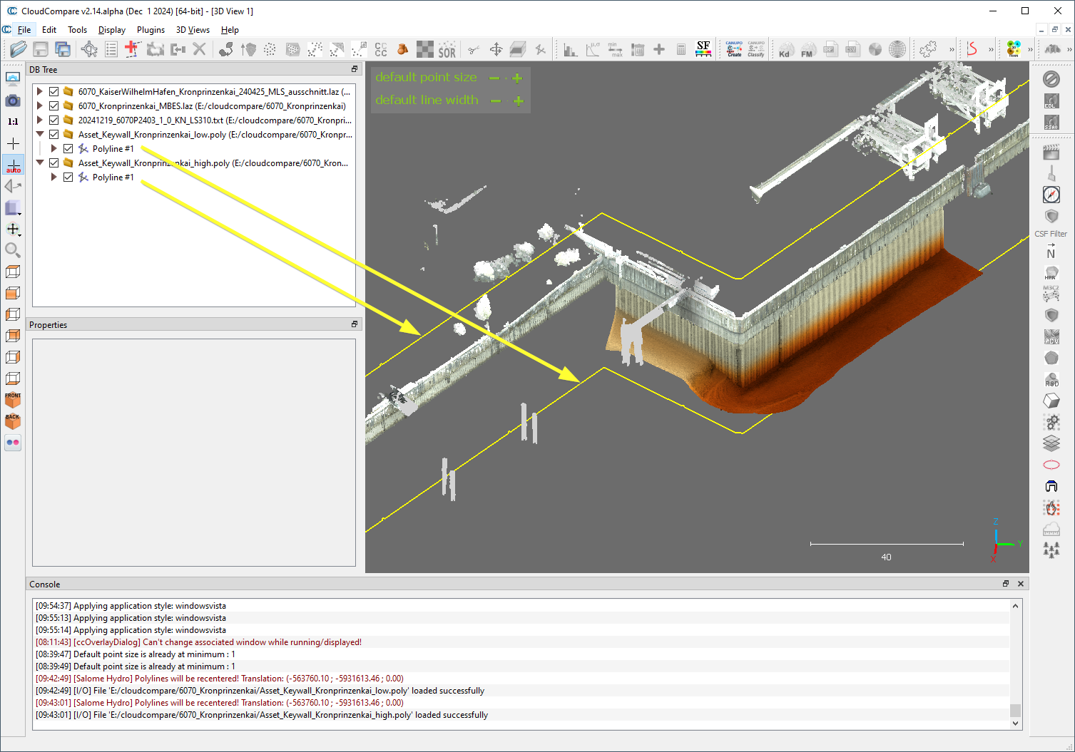

we did a laserscan (and sonar multibeam) of a keywall in a harbour area. I want to colorize the wall against a vertical surface. This is to see if there are any bendings in the keywall. The vertical surface cannot be a simple plane but must be following a given polyline. So i generated two polylines with the same horizontal coordinates but different z values.
Now i use the tool [Edit]->[Mesh]->[Surface between 2 polylines] to generate the surface. Within the following promt i decided to use the best fit plane. The surface is generated.

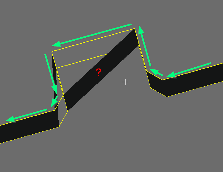

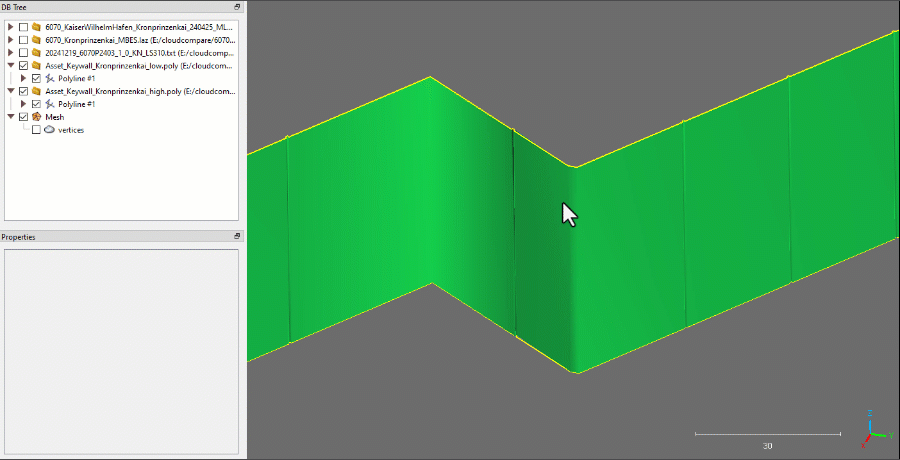

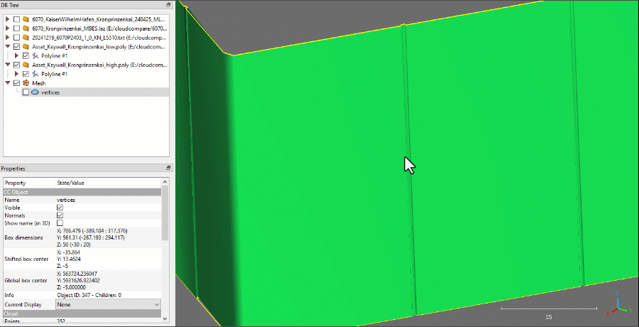

The result of the surface is fine on the wider areas biut there are several small notches in the polyline where the surface is not generated in the way I was expecting it.
The two polylines are attached.

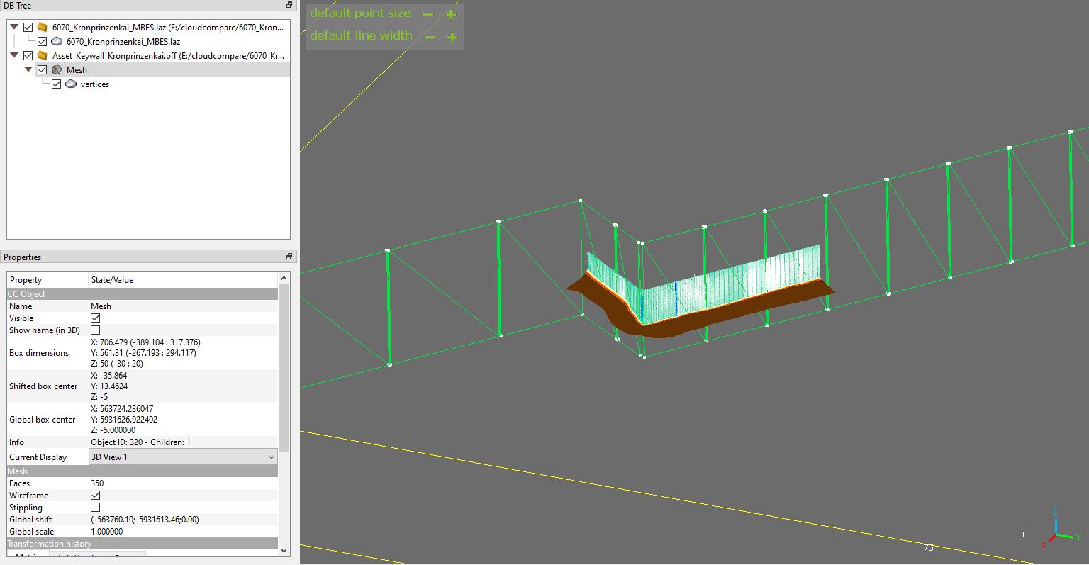

result of [Edit]->[Mesh]->[Surface between 2 polylines]

Sadly this tool relies on 2.5D triangulation, so it's not able to properly manage these small corners (which are 'overlapping' the wall when projected in the global orientation chosen by the tool).

thank you for the hint with the OFF mesh file format. That works perfectly.
With your formula as a beginning I was able to to create it by myself. Instead of creating triangles I ended up created squares. With triangles the front and backsite of the faces were not consistent and flipped. (https://people.sc.fsu.edu/~jburkardt/data/off/off.html)
Just for further reference that was my result where i could compute the distance between pointcloud and the created mesh.
