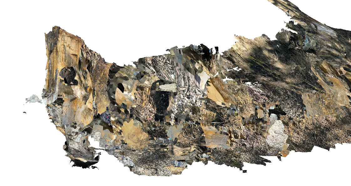

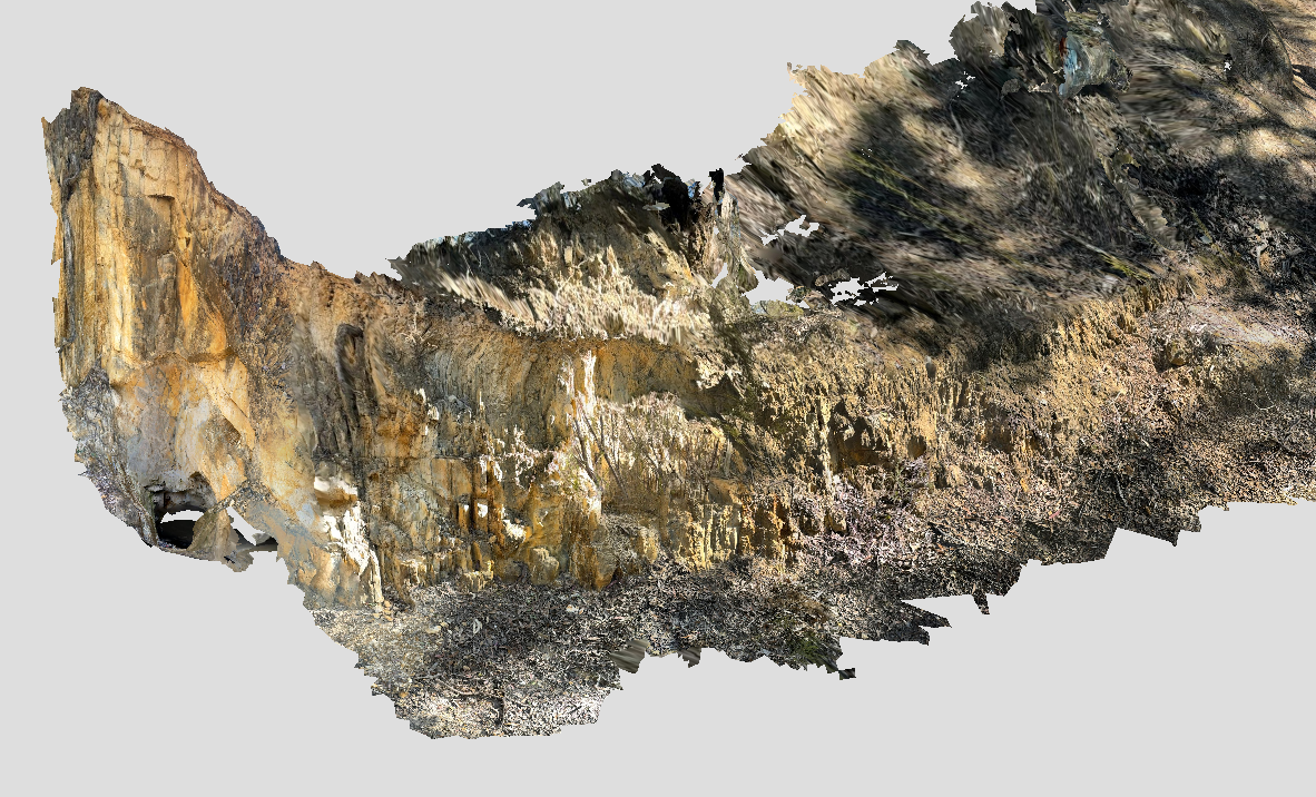

I have successfully imported OBJ files into Vulcan before. Not remembering how I done it previously, I am seeking advice on what I could be doing wrong. I am finding the mesh is importing perfectly, but the draped linked textures are not. They are working in parts of the mesh, but are looking like a camouflaged layer in the 3rd party software, whereas they look perfect in Cloud Compare.
Attached:
Fig 1- Resultant importing mesh with 'camo' patchy texture draped
Fig 2- Correct texture as seen in Cloud Compare

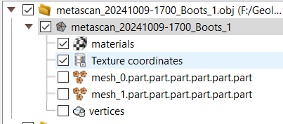

Fig 3- I export as an OBJ the greyed out mesh as seen in the explorer tree (CC).

- Am I exporting all the neccessary files correctly (OBJ) as shown in fig 3 from Cloudcompare? Do I need to export the other unchecked meshes?

Re: Importing OBJ-Preserving Textures in 3rd party software.
No, you are right, only the 'mesh' object at the top (well, just below the main 'file') is sufficient to properly export the mesh.

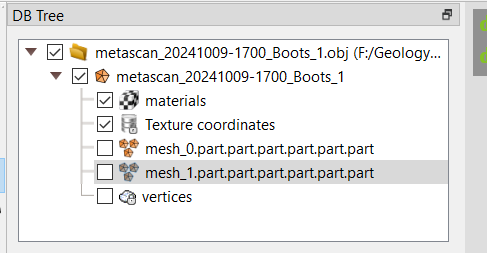

When you open up the .mtl file you can see each material (texture-image) link to what mesh. I believe Vulcan will only import each mesh and cannot handle multiple linked images.
Is there a way to export each individual mesh component separately? (as highlighted in the DB tree image)
Only other possible option could be to manually edit each .mtl file to only contain one material/image per mesh in a text editor?
I am not sure... Have you tried to maybe clone only one child mesh? Don't hesitate to share a sample file with me also (to [email protected])

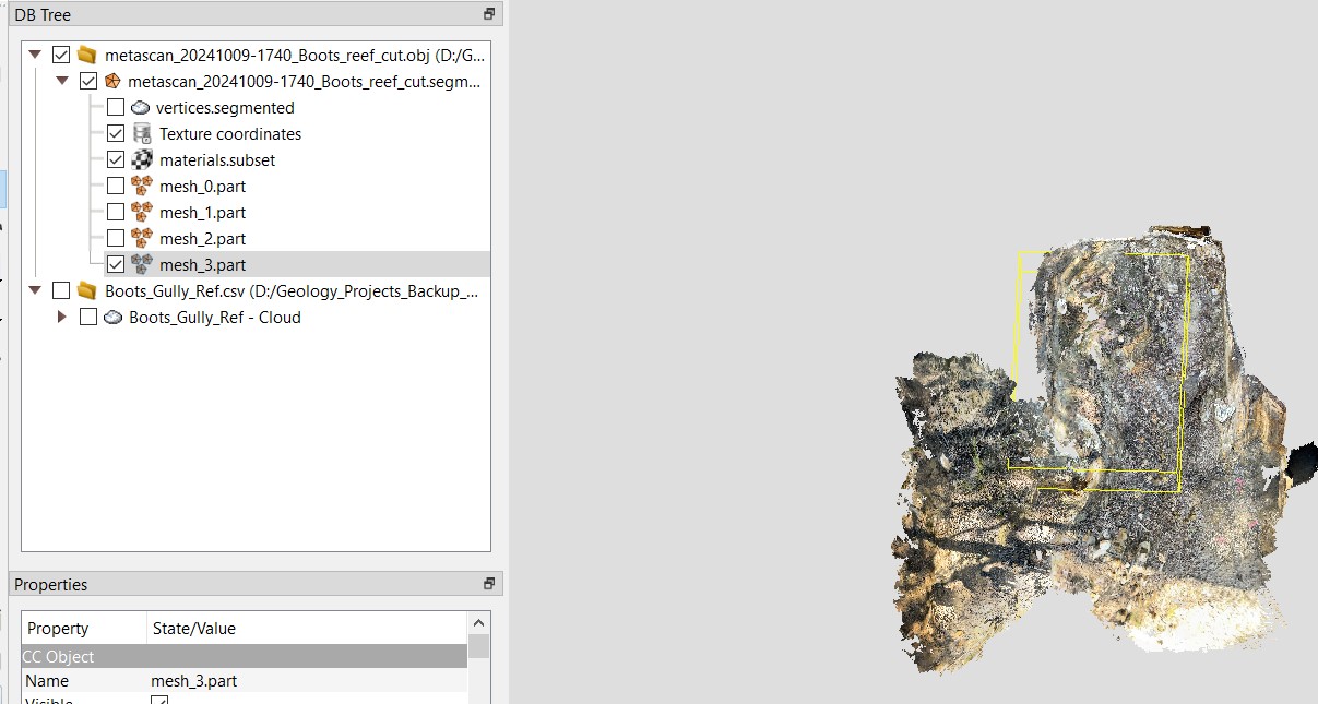

I have returned to this issue and now have resolved it.
The 3rd party software can only import a single image (material) and link to a single triangulation. By exporting as a merged file, the 3rd party software does not recognise the individual materials and triangulations. I have just experimented and found a way around:
If you expand the tree of the layer, you can see there are 4 individual meshes. If I highlight each mesh, I can export them as individual OBJ files. The 3rd party software will then recognise 1 mesh linked to 1 material image when importing each individual file. It will create a lot of files, but this is the current way around this.
