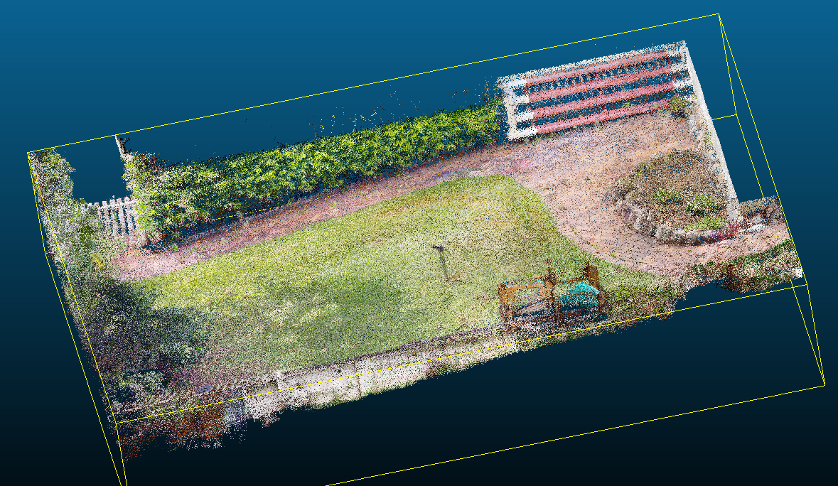

Just want to note I am new to this, originally got a e57 from a pointcloud self created, with the intention of obtaining just the ground level data to make a topograghy in Revit. Since this is multi-step, I started in Recap Pro, couldn't find a solution and eventually made it here
Trying to get a portion of a Pointcloud model into a csv filetype so that i can import it into Revit 2025. Through Massing & Site -> Toposolid -> create from import -> Create from CSV.

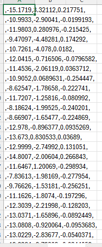

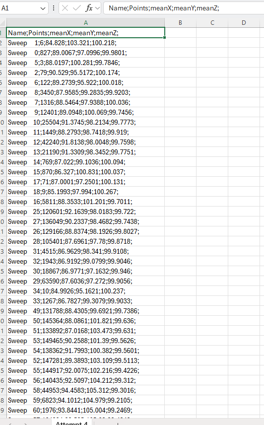

At this point I have been able to create a csv file which has imported to create a portion of the topo, but not the whole thing and not in a straightforward manner. The model imports into Cloudcompare well, but the export, has each sweep's name in front of each line, as well as using ';' as spacers which revit/australia doesn't allow. I went through the csv deleted the name e.g. "sweep 1 colour;intensity" so the lines are just x,y,z and replaced all the ';' with ',' and it mostly imported. but I have should have an approximate square of area and it only imported a trapezoid-ish area.
Basically I want the csv batch export to look like the "csv imported to revit" and include the entire area from CC not just a portion. so batch export to use ',' and to not include the sweep name nor the first 2 values

I don't think you should use the 'batch export' tool, but simply export the cloud as a 'text/ascii' cloud. This way, you'll have all the points exported, no name at the beginning of each line, and you should even be able to chose the separator.
Re: Pointcloud to revit Toposolid
That would create 1 file per sweep/line though, so 45 files. How would you then consolidate that back into 1 csv/txt file for importing into revit?
Also would you know why it's not exporting the entire square? Is there also perhaps a way to make sure it's creating 1 point every 0.5/1m so the output should cover the entire space not just 2/3rds of it?
Just highlight all the lines and use 'Edit > Merge'.
The batch export option only extracts the center of each cloud
Not sure about your other question, sorry.
Thank you very much, this is bang on what I wanted :) :) :).daniel wrote: Mon Mar 03, 2025 1:41 pm Just highlight all the lines and use 'Edit > Merge'.
Also to get the other thing I wanted after merging the lines, I could subsample and set the distance between points at x (e.g. 0.25m, 0.5m, 1m) to make file smaller and easier to maneuver in Revit (obviously losing definition though)
