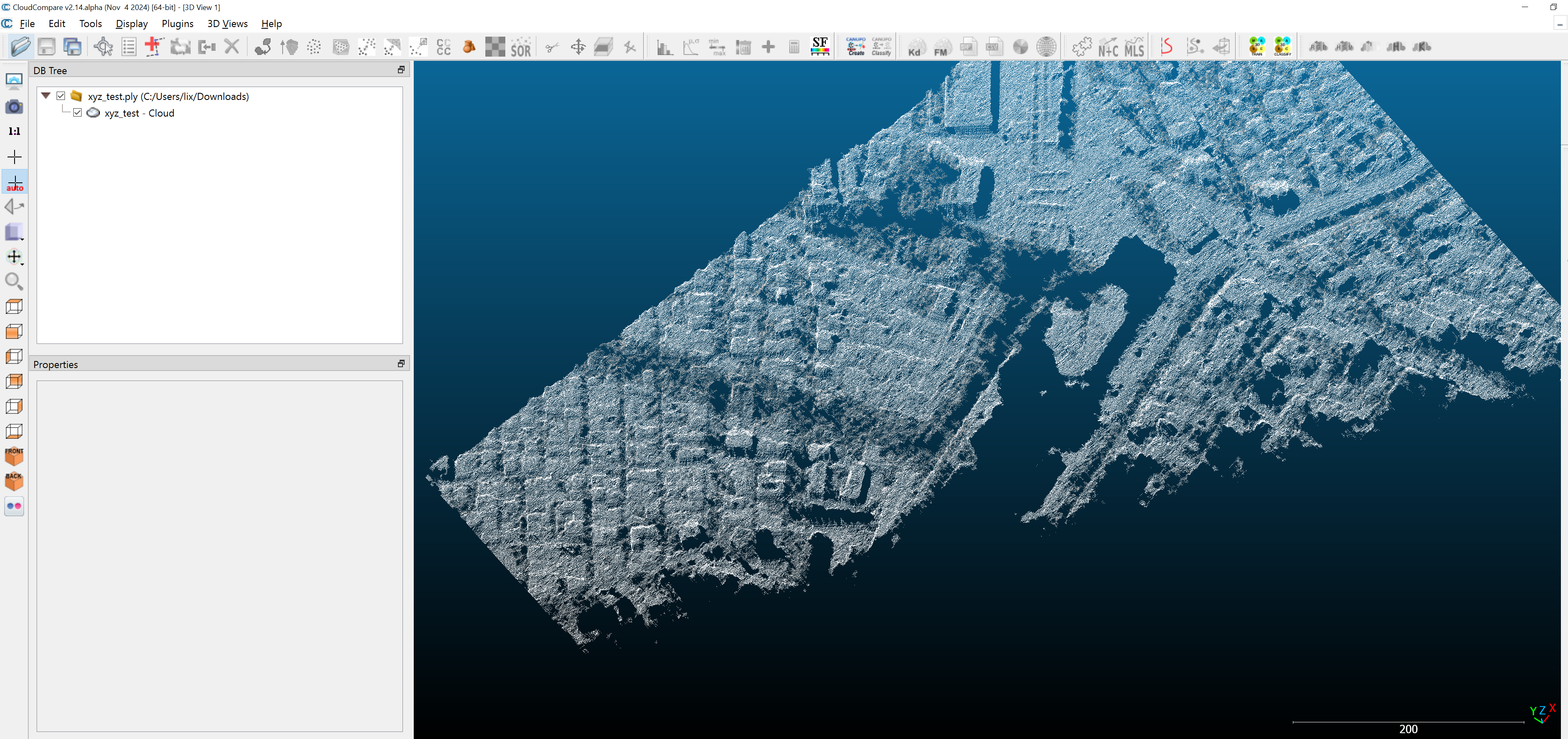

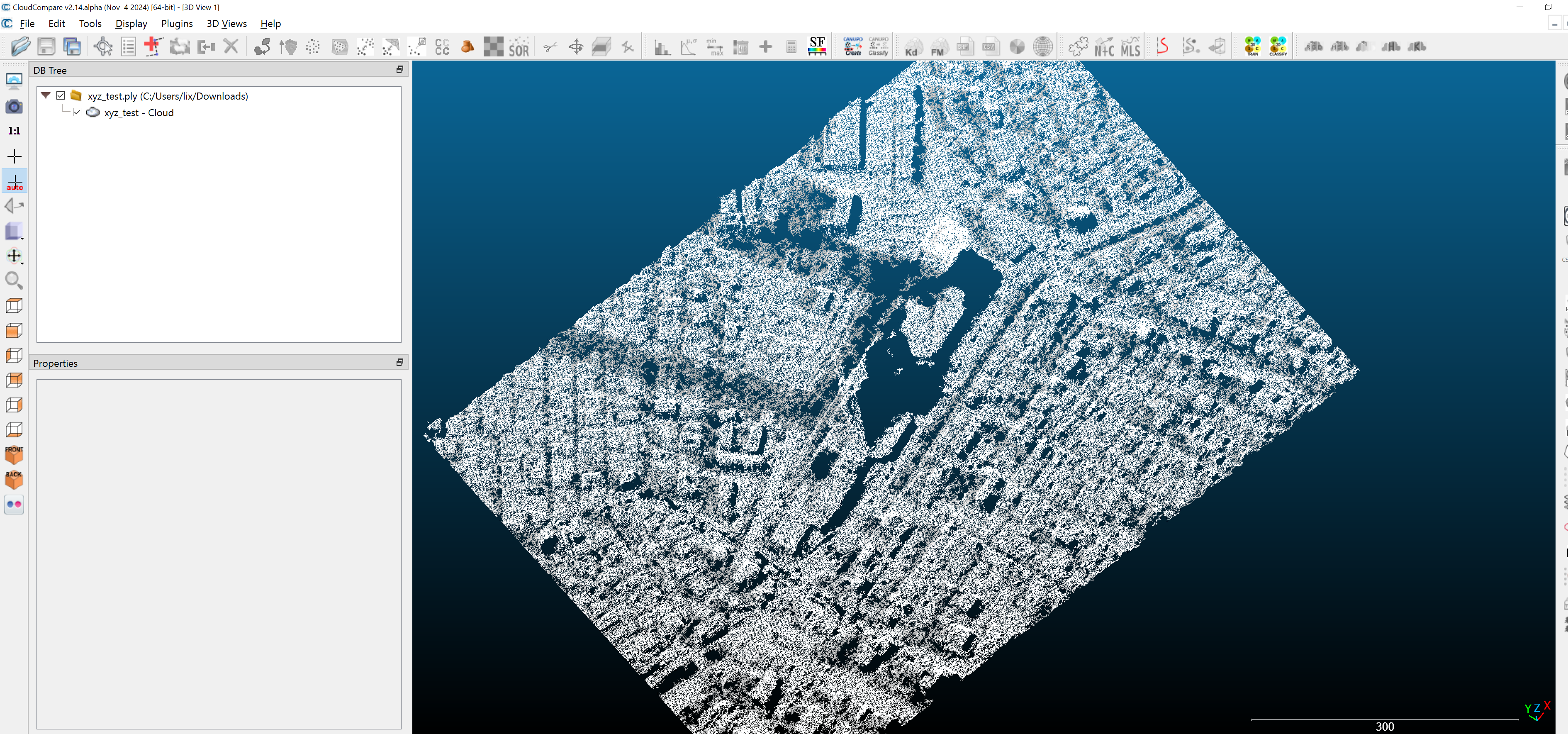

I have been using Cloud Compare for quite a while and I got a quite an annoying display issue,
When I zoom with my mouse on the point cloud, some part of the point cloud disappears in the view mode,
If I try to do cross section for instance this issue disappear,
I guess it is a display setting I removed,
Sincerely,
Pierrick
Re: Points clouds is disappearing when I zoom in
This looks like the 'near clipping depth' that kicks in, probably because you are in perspective projection mode.
You can change it in the 'Display > Camera settings' dialog.
