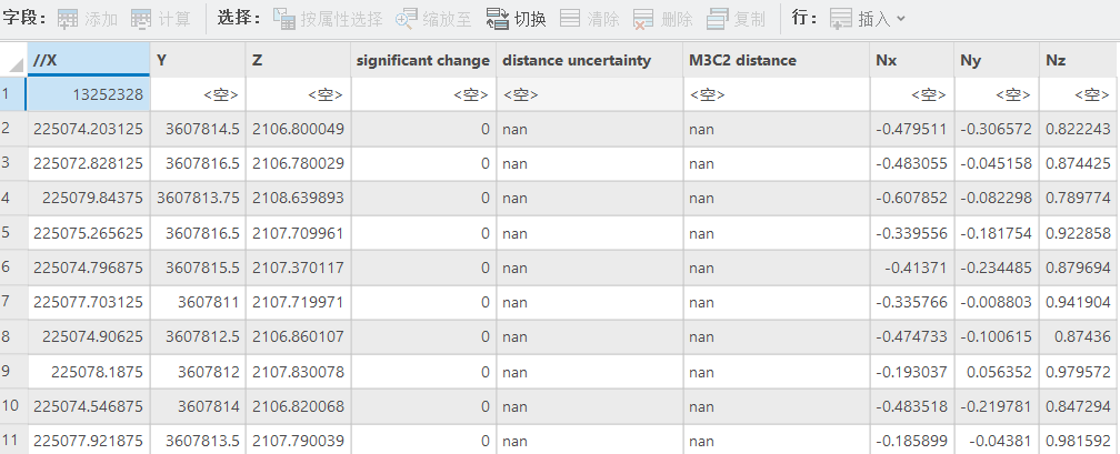

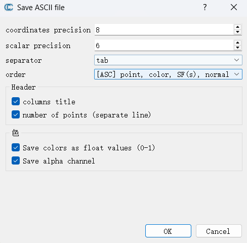

My CloudCompare version is 2.13.2. When I export the processing results of M3C2 to a txt file and then open it in ArcGIS Pro, the data is lost. Why is this?

Does the corresponding scalar field appear in grey maybe in CloudCompare already? Or at least partially in grey? (in which case it means there are already at least some NaN values).
If not, don't hesitate to send me the cloud as a BIN file to [email protected]
