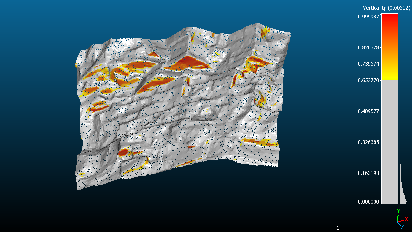

I have a 3D mesh of a cliff face.
I want to select only the upward facing horizontal ledges to measure their areas.
I generate a Point Cloud from it.
I calculate Normals with perferred orientation +Z
I have tried:
    Tools -> Compute Geometric features -> Verticality

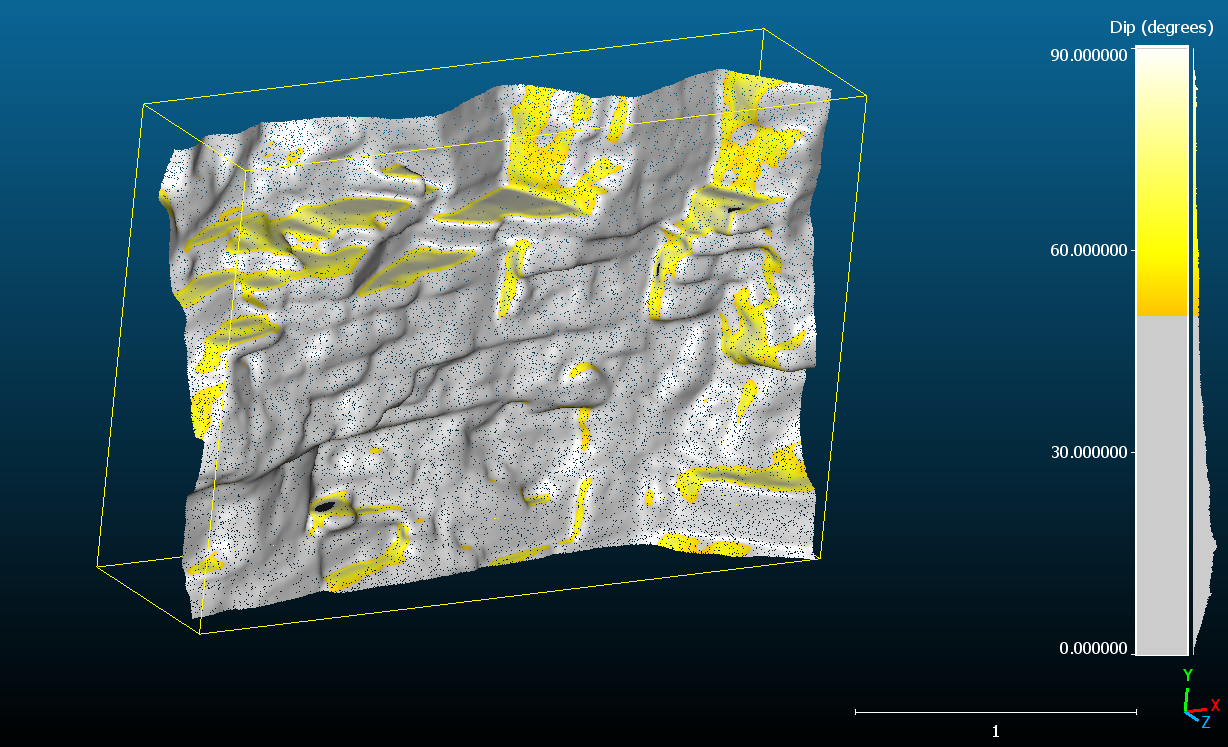

      Edit -> Normals -> Convert to -> Dip / Dip Direction SF
      Both work to highlight the upward horizontal ledges (success!) BUT they also highlight the vertical faces and overhangs.
      Any idea how to filter out the vertical faces and overhangs at all?

      Image 1:Verticality
      Image 2: Dip/Dip Direction SF.

      Re: Verticality or Dip Dip SF - Highlight only the horizontal ledges of a cliff face
      If the normals are properly signed, you can try:
      - additionally, extract the normal components as scalar fields, and find which SF (Nx, Ny or Nz - I would expect Nz) may differentiate the 2 sub-sets (based on the sign typically)
      - or try your luck with the 'Stereogram' tool of the Facet plugin
