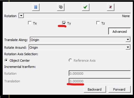

I get a strange behaviour from inside the Translate tool:
whenever i want to use the "Backward" or "Forward" buttons from within the "advanced" mode, to do a fine, step by step adjustment to my pointcloud, the Translation input box, where you set the step amount by typing it into, is always disabled WHILE there is only the "Ty" movement flag on.
Here's a screenshot:
In other words, i cannot use that function for Y direction, but it works flawlessy when i select Tx or Tz. In every case, the Ty is ignored, even when checked, the step function stays disabled.
Here below, screenshot with cc version and the form as described. Logic would suggest me that somehow my setup is wrong but i really cant figure it out. I tried to change the POV, thinking about some lock that occours while the view is aligned by some plane, but had no luck

I guess it's a bug... I'll take a look ASAP.

Can you try with the latest 2.14.beta version online?
I've updated the code and made some simplifications. At least I was not able to reproduce the issue afterwards.

Hello there, putting the 2.14 beta in c:\user\xxx\Desktop instead of Documents for some reason solved the issue, although this does not sound as a proper solution, both dirs should have the same rights/policy.
Anyway, i've tryied the new Transform Tool and it do fix the "Ty" box not being enabled. Thanks.
