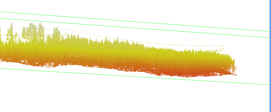

I have an airborne lidar point cloud data set of a forest strip. Within this forest pointcloud there's a corridor of hanging powerlines. The raw data only has xyz values.
What I want to do is to create an algorithm that automatically extracts the powerlines,gives me the coordinates and measures the length, and curvature of each powerline.

- Screenshot of powerline
- side_Lidar_powerlines_forest.png (105.28 KiB) Viewed 7331 times

Wow, quite ambitious ;)
There's several way to segment the power lines. Maybe the best one would be to use the CANUPO classifier (qCanupo plugin: http://www.cloudcompare.org/doc/wiki/in ... uginCANUPO). Should be quite easy to train in order to detect directly the power lines (as their "dimensionality" should be very singular). If you need help don't hesitate to send me a sample point cloud (cloudcompare [at] danielgm.net).
