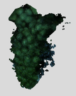

Okay, thanks for the files.
Actually, the color may let you think that the berries are not that badly reconstructed by the photogrammetric process:
The attachment Capture1.PNG is no longer available

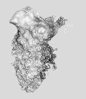

But it's in fact actually as bad as it should be:
So that's no surprise that the qRansac plugin doesn't detect anything. And I don't see how you could segment them or compute their volume (at least not with CloudCompare ;).
